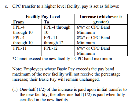

I have a question and possible likely scenario. Currently I am cpc at lvl 12 and trying to ERR to lvl 10. I still have 20 years left in my career. I would fall in-between the lvl 10 pay band and keep my base pay, but would cap out in approximately 5 or so years at lvl 10. If at some point down the road I wanted to transfer to a lvl 11 it says I would get an 8% raise but that would put me over the cap of a 11 so I would get 0 raise according to the Note: portion of that post. In other words, I would have to transfer to a 12 not an 11 and then I would get the full 8%? Am I reading this correctly?
First off don't look at base it's often confused on here. Look at your basic in eOPF and put that into the basic bands without locality. If you have 20 years left then yes your 12 basic definitely fit in the 10 band. So you'll save basic pay on transfer. Then if you went from that 10 to an 11 you'll get 8% basic raise (4% on the go, 4% on checkout) unless it puts you over the top of the 11 band. You always stop at the top. So all the math is done with the basic pay numbers and then locality add on is the last step. So you can go from a 12 down to a 10 and actually get a base salary raise if you're moving into a higher locality area. And conversely, for example, say you went from SFO tower to a 12 with rest of US locality you'd get an 8% basic raise and it would still translate to a monster ~23% paycut even though you went up 2 levels.
I shouldn’t use the word base, I meant my basic pay. I think the “Note:” portion that is written is just a bit confusing to me. For instance if you were to use today’s numbers, let’s say your basic pay is maxed out at lvl 10 at 135,499. You accept ERR to lvl 11 which results in 8% raise total to basic which would be 146,339, however the lvl 11 max basic pay is 142,610 currently. According to the “Note: Employees whose Basic Pay exceeds the payband maximum of the new facility will not receive the percentage increase; their Basic Pay will remain unchanged.” I understand to mean you would not recieve any raise then to your Basic Pay. Or do you think that means you only recieve up to the maximum and no further?
correct
You'll go to the top of the 11
Did 12-10-11. Hit pay cap at 10, and then transferred to 11. Couldn’t get whole 8% due to cap, so I got about 6%. Half on go, and half after. Still get a raise.
Thanks that’s exactly my situation, well at least what I’m hoping haha
